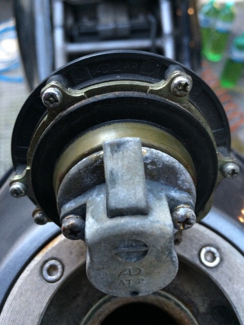

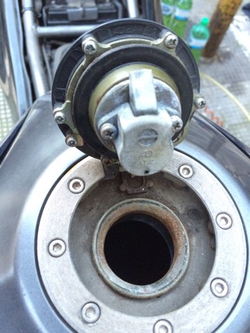

Attached picture
pnardo70
Beiträge: 43
Registriert: 12. Feb 2009, 22:42
Wohnort: Taranto Italy
Re: Wasser in banzintank , tankdeckel oder ??
Beitrag von pnardo70 »
Detail of gummy
Bold gummy
Bold gummy

Try to remove the 2 screws on the bottom of the tank cap.
My bike was full of water too, inlet of the tank was rusted, so I cleaned the rust and painted it with powder paint - it is resistant aggainst gasoline.

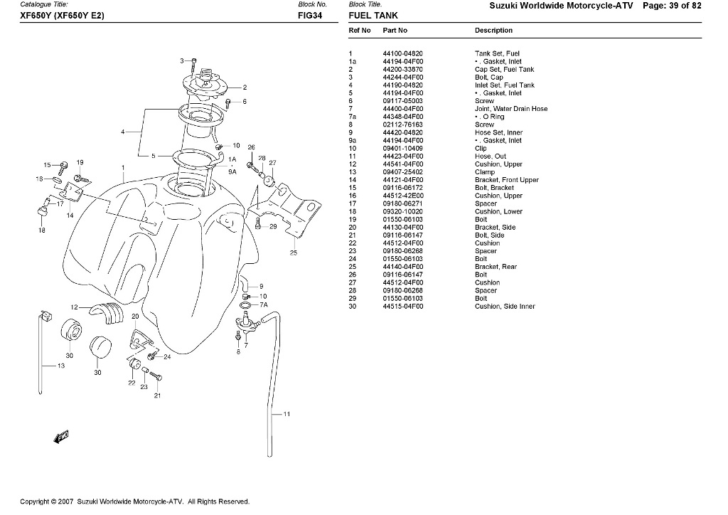

Does somebody know the OEM number of the ruber gasket? In the spare parts catalogue there is no record about it :-(, only whole cap set.

I think the main reason may be the closed draining hole and hose. The gasket looks not too bad.
