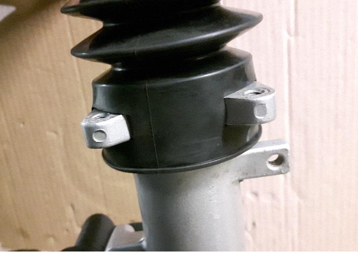

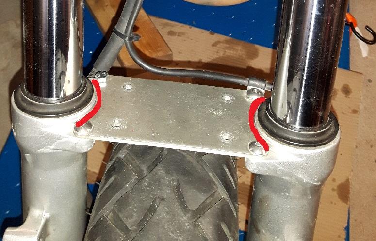

I got mine from ebay. They were for Harley Sportster. Enduro fork boots are much longer typically and I did not like that look.
Fit to fork:
You may need to grind the ends of this fork brace / front mudguard bracket so that the rubber fits between fork and the connector plate.

Melitos hat geschrieben: 14. Okt 2022, 19:48I got mine from ebay. They were for Harley Sportster.
So were mine! :D
Melitos hat geschrieben: 14. Okt 2022, 19:48Fit to fork:
Love the idea! I never thought about doing it this way... I was basically thinking about doing a cut-out around the entire brace and not just the parts where it's screwed onto the fork... this might be something to do over the winter (in case we get one).

von aGentleFreeWinder
@Melitos
Thank You! That is a clever solution!
