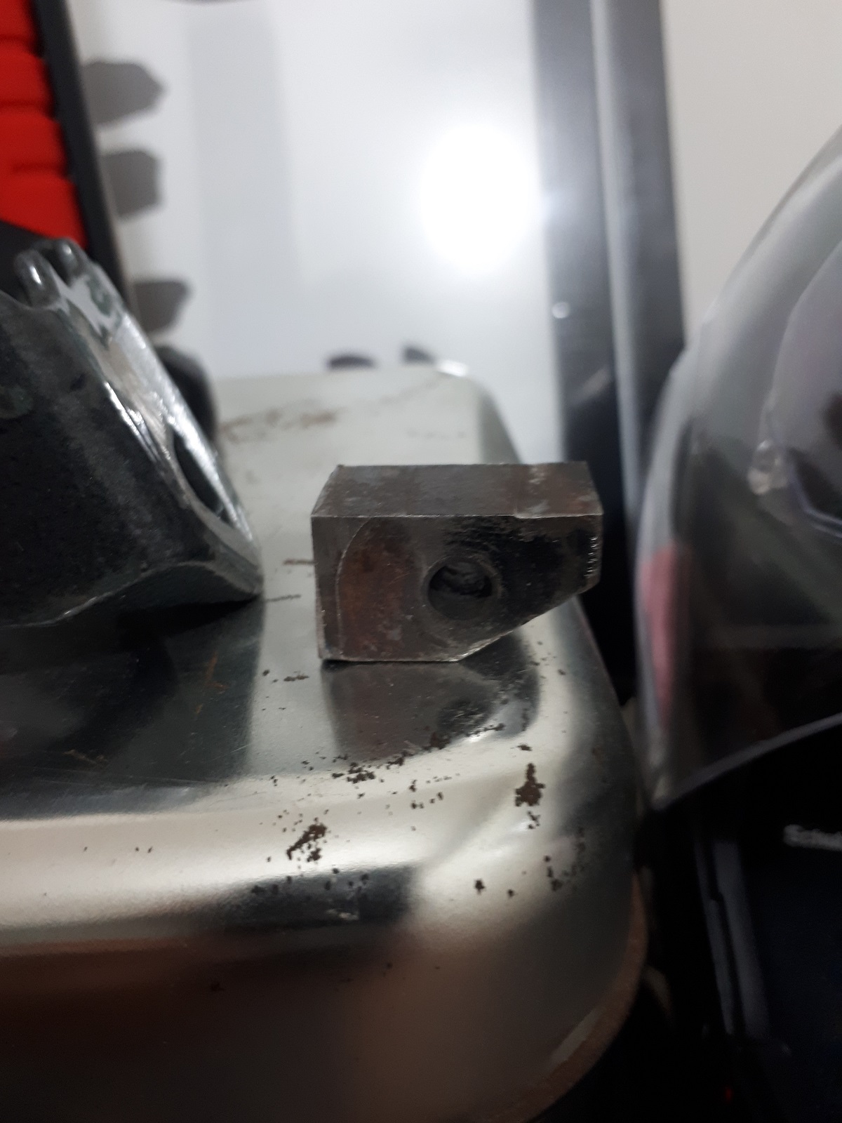

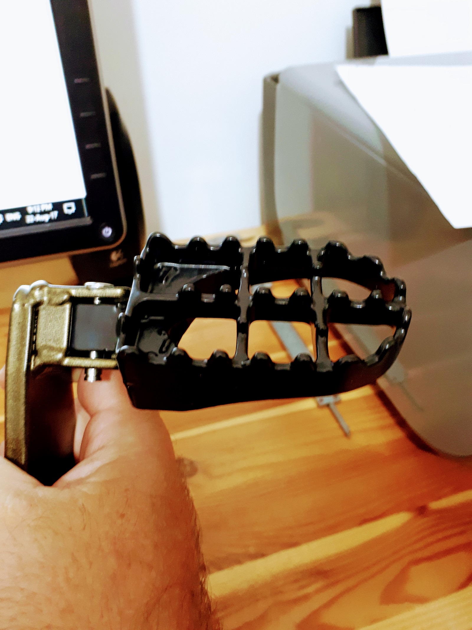

After not finding anything, i had to make them myself:
Re: After market footpegs
Those look decent. How did you do it? What parts did you use?

I purchased aftermarket Pegs for DR650 on Ebay, Cut off the mount, the i cut a piece from the original foot pegs and welded it to DR650 pegs.
I made new Stainless steel pins on the lathe.

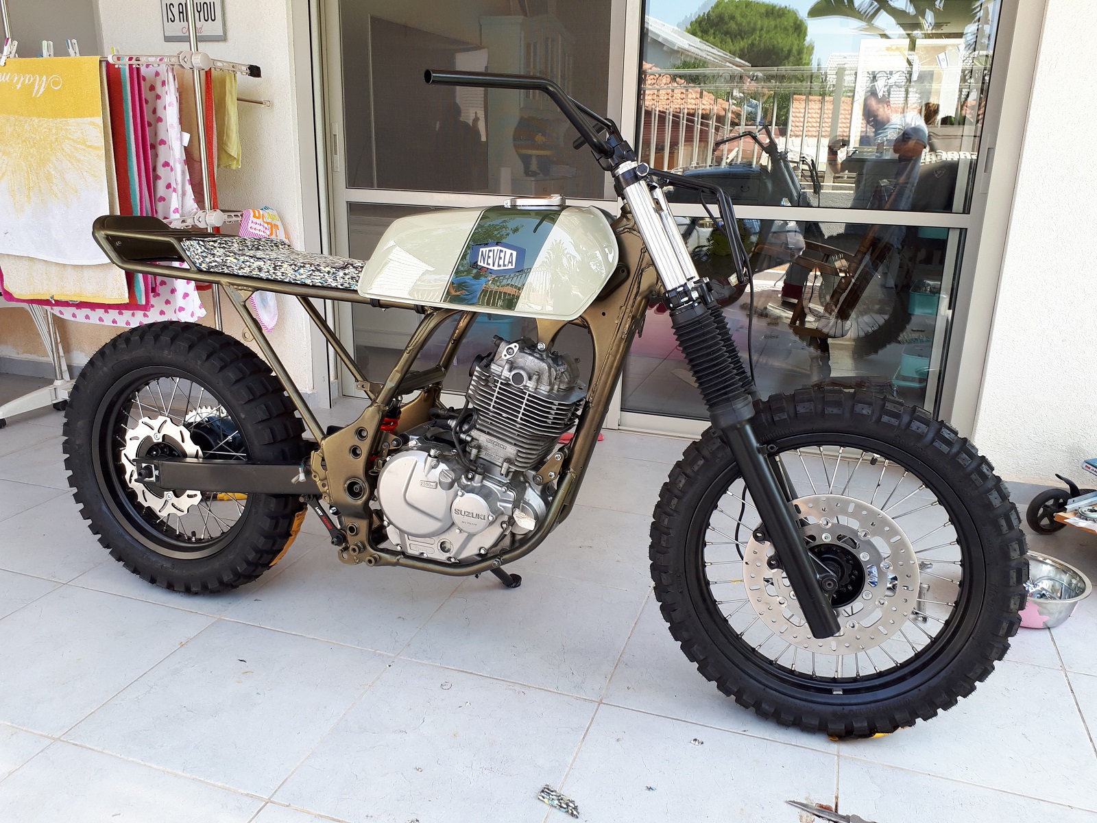

Well, it's not going to be a regular freewind
