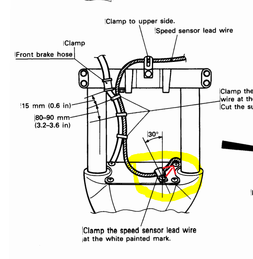

I've already found some:
The speedo gear cable should be clamped in the rear left corner.

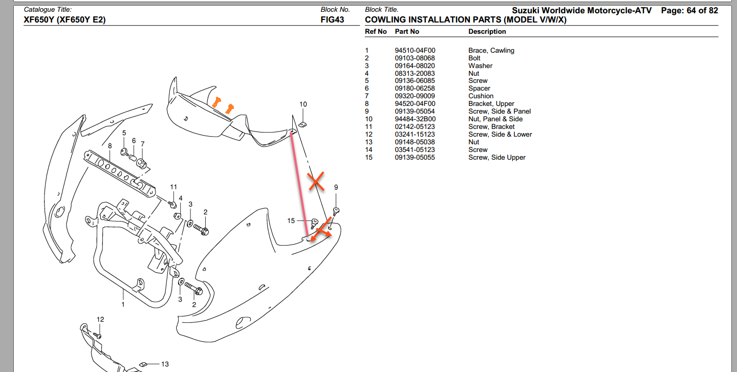

The black line goes to the front hole, together with the screw, and the screw in the front should be in the back.
Also there are 2 screws that are missing completely from the diagram, painted in orange.

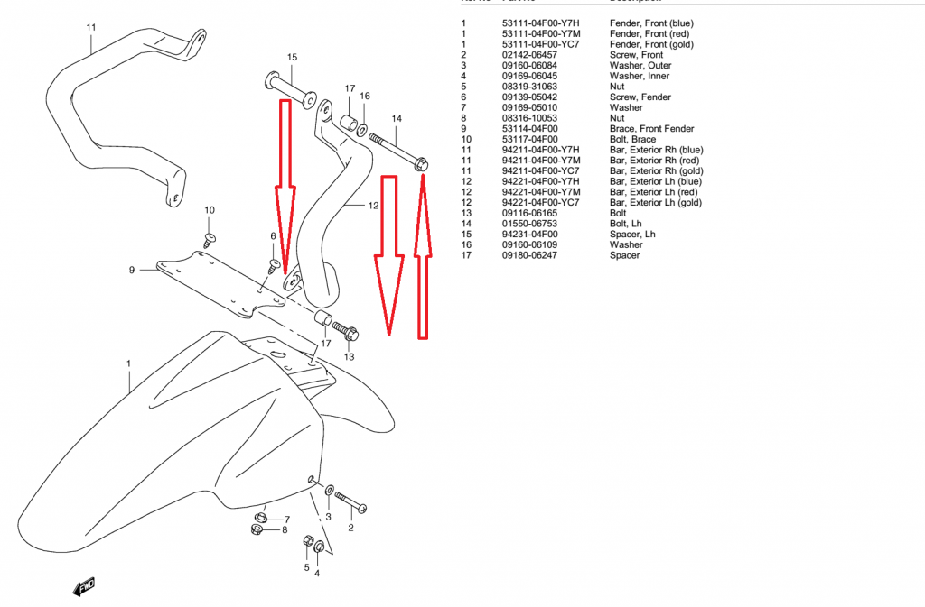

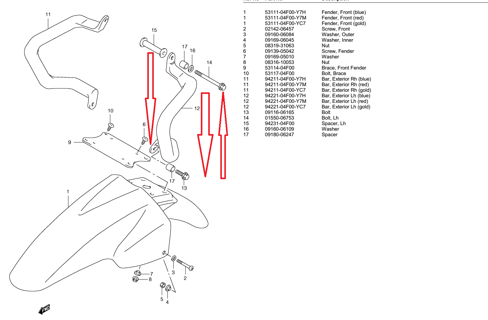

The long spacer and bolts should be at the bottom and not at the top.
