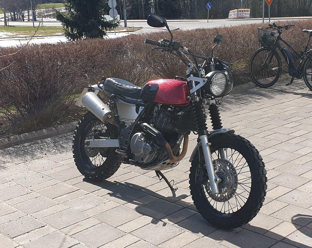

Hello,
After reading this forum (through google translator) for already a few years, I want to present my Scrambler conversion.
Going into the garage
Coming out of the garage after 2 years
New handlebars, footpegs and headlight grill
Tank: Honda CB350 Four, modified to sit properly on the frame.
Exhaust: Ducati Monster
Tires: Conti TKC80
Fenders, mirrors, lights: Kickstartershop, ebay, Louis...
Footpegs: KTM adventure with self-made mounting brackets.

I am still alive, and so is my Freewind Scrambler.
It has been quite an effort to set the new carburettors properly. Had to special order new jet needles from Japan to lean the mixture. Jets I can buy from Finland but not the jet needles. Covid 19 is not really helping with delivery time for parts. I have had PLX wideband O2 sensor in the exhaust with bluetooth connection so that I can see mixture from my phone (which I have had attached to handle bars).
Now I have very good low speed cruising around town with smooth ride from 2500rpm and good acceleration all the way to rev limiter. Huge improvement over the original Mikunis even though some further tuning might be needed.
I also had a leak in my fuel tank which I noticed late last year so I used POR-15 tank sealer to coat the inside of the tank. The outside also got new professional paint with lots of flakes 8) The picture was taken already many weeks ago during first ride with new carburettors (and bike running with very rich mixture).

Hello again
New exhaust, larger diameter manifold from the well known German Suzuki enduro specialist. Self-made connecting pipe and titanium silencer from 2002 GSXR 1000 (weight ~2.1 kg). Also cover for rear brake master cylinder including bracket for Honda HRC style brake fluid reservoir (only a short clear hose with cap).
