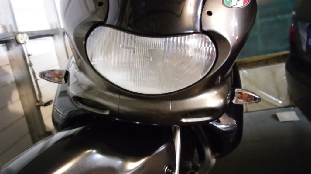

Re: Mounting other turn signals
Since I've bought those turn signals from a local store (21€/set), the time of delivery was drastically decreased.
Here's a pic of my bike now
I had to remove the whole front fairing (including windscreen, that's why there are missing bolts), just to install the turn signals.
It was about 2 hours of work in total.
But it looks good, that's what counts

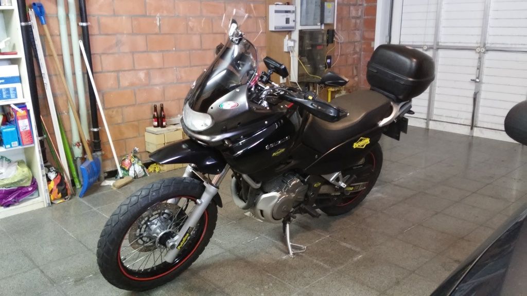

i have a combination of turn signals and Handguards...
bougth at Louis...
mounting them isnt a big deal... if you want i can make better pictures of the handguards...
MfG
MfG

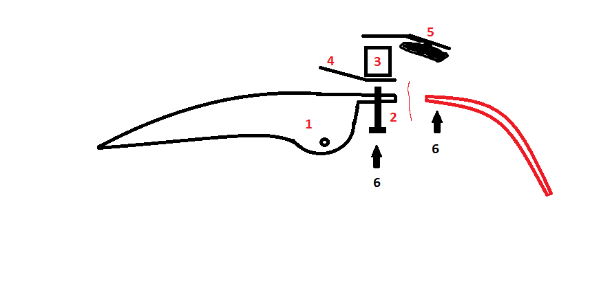

Now to attaching the front fender so high:
Picture:
How to:
1) Cut the front fender in half (arrows (6) indicate factory screw holes) and drill 2 holes that correspond with the horn bracket mounting holes. (1)
2) Use the original bolts that hold the front part onto the fork and put some washers on it. (2)
3) Use the factory plate that is behind the horn and put it on the fender (4)
4) Use a spacer that's about 3cm high and place it between the horn plate and the horn bracket (3)
5) Turn the horn bracket 180° so that the horn is the closest to you (5)
6) Make sure you still can connect the horn to your electrical system by bending the metal connectors 90°
7) Mount this to the factory horn bolt on points on the underside of the triple tree.
Also make sure you have adequate protection on the underside of the fairing that holds the headlight. The fender would jump around when you're riding
